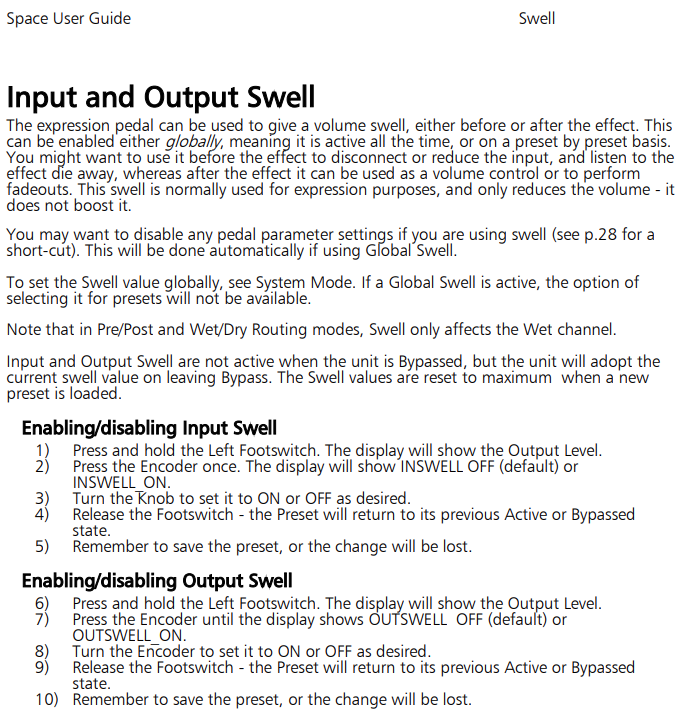

                  • #195344
                      Have you tried out this approach?
                      Space In-Out Swell

                        • #195405
                          audio.ole
                            Yes, but the swell controls entire input signal, not only wet input signal. What I want to do is to fade signal going through fx without impacting dry signal. Looks like I can’t do this in a mono chain.
                        • #195406
                          audio.ole
                            I think I will try to found a cheap passive mixer pedal and use the wet/dry routing mode of the Space, with INSWELL on.
